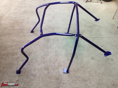

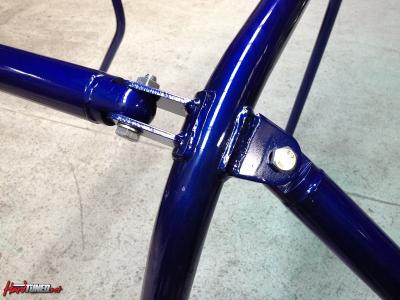

HFM 6 Point Roll Cages to Suiting S13, S14, S15,180SX - Metallic Blue Finish
Seats around Dash. Material Mild Steel, 40mm OD, 2mm Thick, Total Weight 15kg
Everything for Installation is Included:
Bolts
Nuts
They Do Meet VicDrift Regulations
Click Here to Check Them Out!

Any pics of it fitted
First bolt in cage that suit all s13 s14 s15
we are hoping to get our hands from a buyer of them fitted to share. as soon as we do we will have them posted

 MRSR20, on 01 April 2012 - 09:39 AM, said:
the cages would meet their current requirements for passengers.
however from what I've heard, September onwards side intrusion bars will be required.
What you heard is wrong, side intrusion is only recommended.
The reqs are that it must be a CAMS spec half cage minimum with a diagonal bracing bar on the main hoop.
I think the min thickness of pipe is something like 44.5mm or 45mm or around there so I'm not sure if these are suitable.
Yoshi said something that you guys are looking at swapping the hoops out?
#16 ScottD
  • Joined:29-October 09
  • Car:S14a, BF F6
Posted 19 April 2012 - 06:42 PM
main hoop must be 44.45mm cold drawn seamless tube as of next year , all other arms must be atleast 38mm
